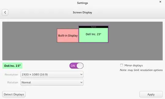

How can I make the monitor settings be saved after reboot?
I have configured my monitor on my Lenovo T410S like this:

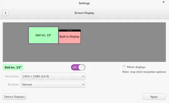

after reboot its however reset to this:
Interestingly, my monitor.xml looks the way I wanted it:

xorg.conf is where you can make persistent changes. It should be saved in /etc/X11/xorg.conf
An example of the server layout portion would be something like
Section "ServerLayout" Identifier "seat0" Screen "screen0" 0 0 Screen "screen1" 1920 0 InputDevice "mouse0" "CorePointer" InputDevice "keyboard0" "CoreKeyboard"
EndSection
Where screen1 is 1920 pixels to the right of screen0. Your screen0 and screen1 will also have to be configured. You can do so by running sudo X -configure when there is no X session (recovery mode can do this) and then save the xorg.conf.new file. When you have a configuration you would like to test, write it to /etx/X11/xorg.conf. Don't forget to backup your working xorg.conf if you have one.
