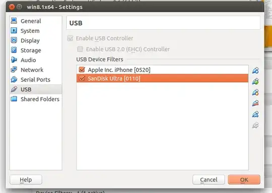

At first i could not see any actions when selected on Virtualbox side. After adding my username with sudo adduser yourusername vboxusers command Windows recognized all usb devices plugged in. But at the "Device Manager" tab, there is a exclamation mark. Although Windows try to install drivers for the usb nothing happens. This occur for all usb devices. Here is screen shots of my device manager.
Windows side: image
Ubuntu Virtualbox parameters: ubuntu

For Ubuntu 14.04 default VirtualBox package version (4.3.10) USB 2.0 support is integrated but there is still no USB 3.0 support. Consider this while trying to use your USB ports.
For adding specific USB devices to your VirtualBox's guest you need to add your user to vboxusers group via sudo adduser yourusername vboxusers
If you plug your device to an USB 3.0 port of your PC, Laptop etc. a Windows guest will then give this error:
