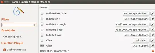

If you have Ubuntu, you should have compiz, so use compizconfig-settings-manager to turn on some plugins. This manager is in software-center with plugins too. When you will have some problems with crashing of compiz because your testing, install fusion-icon to quick reloading it.
compizconfig-settings-manager can be launched by command ccsm.
Annotate (under Extras): Drawing on the screen.
screenshot
Enhanced Zoom Desktop (under accessibility): Does that zoom.
screenshot
Set-up shortcut as you like and enjoy. :)
