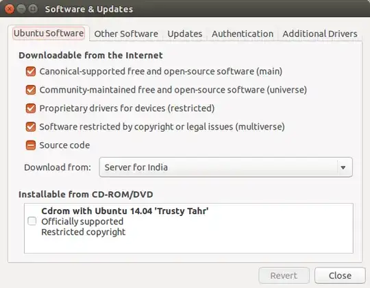

Make sure you have your "Source code" entry check marked in "Software and Updates".
software and updates screenshot
If not, check mark it and and open a terminal and:
sudo apt-get update
(you probably don't need to do this, if you get a dialog box asking you to reload the package list after you have check-marked if if was not) and then do:
apt-get source libtiff4-dev
to fetch the source code for libtiff4.
