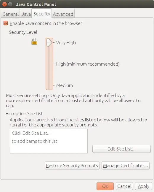

How can I open Java's Control Panel to change the security settings?

If you've manually installed Oracle Java it doesn't show up in the Dash (as far as I know).
  1. Open a terminal
  2. Execute the following command:
    /usr/bin/jdk1.8.0_05/bin/ControlPanel
    Replace /usr/bin/jdk1.8.0_05 by the path of your Java installation.
17
Open a terminal (Ctrl-Alt-T) and start
ControlPanel
Just a few moments later the Java Control Panel appeared. I haven't checked yet, but it may be necessary to
sudo ControlPanel
to save your changes.
