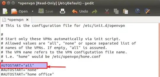

Edit /etc/default/openvpn. Just press Ctrl+Alt+T on your keyboard to open Terminal. When it opens, run the command(s) below:
sudo gedit /etc/default/openvpn
Uncomment the AUTOSTART="all" line. Save and close. Reboot your system.
