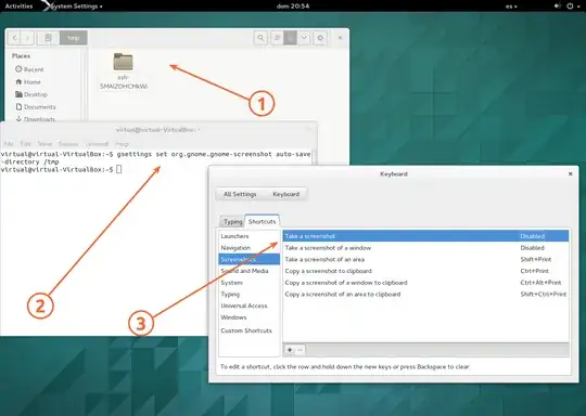

1) I set the auto-save-directory to /tmp:
  • gsettings set org.gnome.gnome-screenshot auto-save-directory '/tmp'

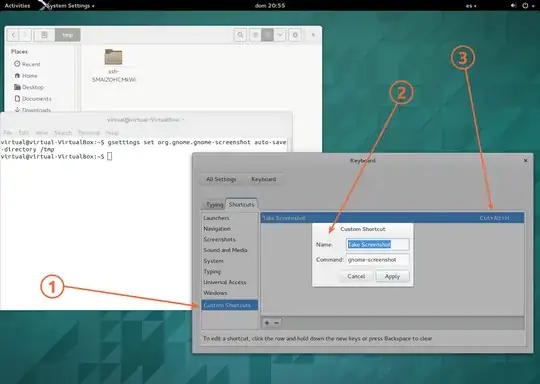

2) I disable the keyboard shortcut Print and I created a new one to run the gnome-screenshot command with the shortcut Ctrl+Alt+H . Then I pressed the new shortcut and the screenshot appears in the /tmp directory.
So, set the auto-save-directory value works for gnome-screenshot, but to solve this issue you can try to disable the default keyboard shortcuts for Screenshots and create new ones but running the gnome-screenshot command.

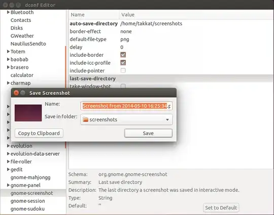

You can set the directory with the dconf command.
Command line
In this example I'm going to set my Downloads directory.
dconf write /org/gnome/gnome-screenshot auto-save-directory \'/home/youruser/Downloads\'
Please put the full path to the folder... My case /home/virtual/Downloads
GUI with dconf-editor Install dconf-editor

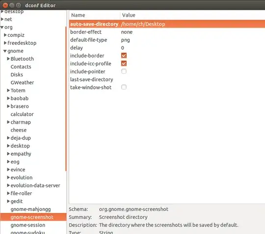

Just install dconf-editor:
sudo apt-get install dconf-editor
Open dconf-editor and edit the auto-save-directory field (see screenshot below):
  • org > gnome > gnome-screenshot
