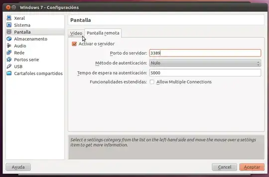

It is not clear what connect means here. But if you are trying to connect to your VM using Remote Desktop then you have to forward the 3389 port on you router to the host ip (where host is the computer running the virtual machine, not the one running on the VM).
You will also need to have installed the Oracle Extension Pack and have enabled RDP in the Virtual Machine settings.
Sorry for the spanish screenshot, I hope that you find the place in your own language.
About the authentication:
  • None means that there is no authentication, the system will let you connect the same way that a local screen, i.e. it will only ask for a password if you are not logged or you had blocked the screen.
  • Extrenal uses some external method to authenticate. In a linux host that means that you will need to use a PAM server. Not really useful for personal use. One note: you can use this to hook into your own authentication lib, which is really geeky.
  • Guest uses your guest authentication system. If you are running a windows guest, that means that it will always ask you for your windows user and password to let you log in. This is the easiest way, but you will need to have the Guest Additions running on your guest to be able to use it.
You can find much more info in the user manual.
