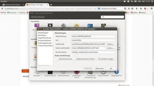

  • The printer can appear twice in cups (once for auto-detected USB printer, once as Canon CCPD daemon) but the "USB" printer will not work if you try and print to it. In printer settings, if you see your printer configured as USB printer, you must manually disable it (right click, disable)
