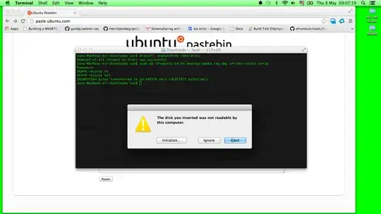

$ sudo dd if=ubuntu-14.04-desktop-amd64.img.dmg of=/dev/rdisk1 bs=1m
Password:
964+0 records in
964+0 records out
1010827264 bytes transferred in 24.643578 secs (41017877 bytes/sec)
NOTE: wired popup came out , press IGNORE
$ diskutil eject /dev/disk1
Disk /dev/disk1 ejected
