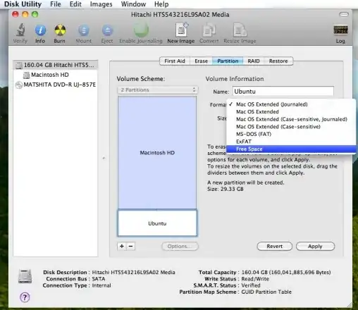

  3. Use OS X Disk Utility to resize your HFS+ partition
    • Create a partition for Ubuntu (create two partitions if you want a swap partition). Choose any partition type (it does not matter because you will overwrite them later).

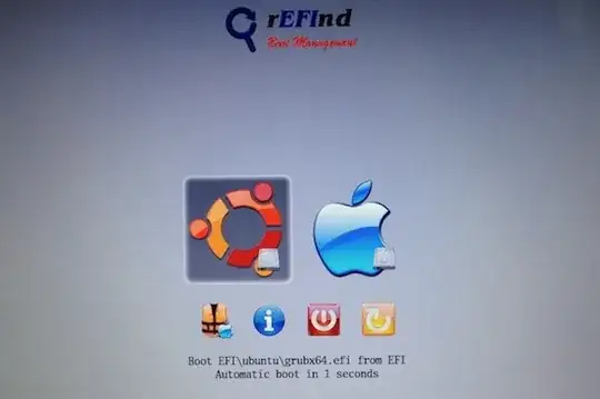

  10. Refind will load and show you the option of booting OS X or Ubuntu. Choose Ubuntu.

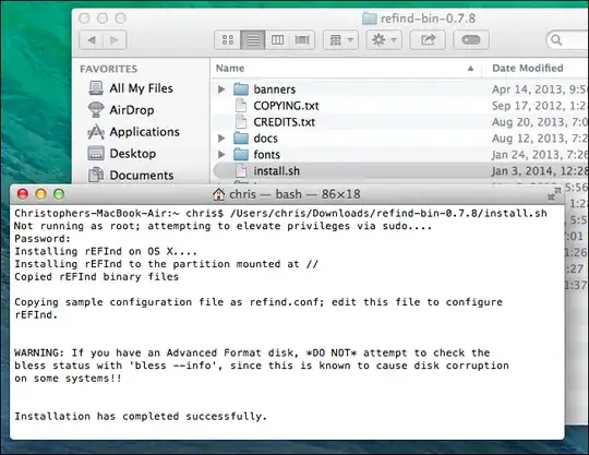

First, visit the rEFInd page on SourceForge and click the Download button to download the latest refind-bin-[version].zip file. Open a Terminal window by pressing Command+Space and, typing Terminal, and pressing Enter. Drag and drop the install.sh file from the downloaded zip file into the terminal window and press Enter to run it.

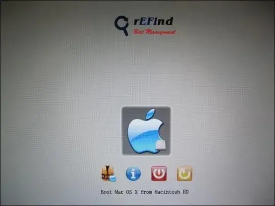

Shut down your Mac — a full shut down, not a restart — and boot it back up again. You should see the rEFInd boot manager screen.

While the ISO is downloading, use Disk Utility to partition your HDD. Make sure to leave the partition you create as "Free Space". (No filesystem)

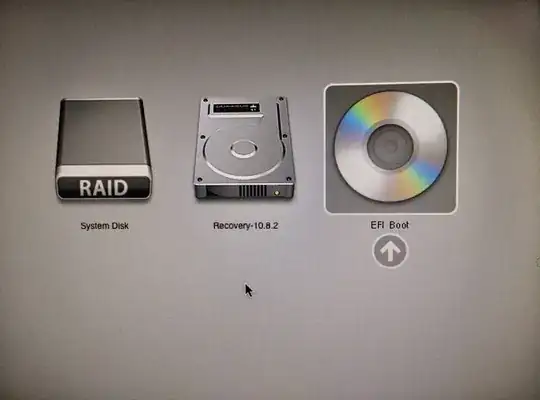

Next, hold down the Option key while hitting the power button. Continue to hold it down until you get the boot device selection menu. Then you want to choose "EFI Boot". It will show a picture of a DVD if you burned it to a DVD, and it will show a picture of a drive if you burned it to a USB stick.

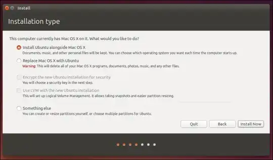

After the installer loads, select the "Install Ubuntu" option, and then select "Install Alongside Mac OSX". Hopefully, it will automatically install to the partition you left as "Free Space" earlier.
After it installs, shut down and remove the installation media. Then reboot, and cross your fingers. Hopefully you'll see this:
