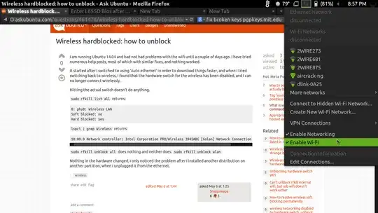

Also, check this setting "enable WIFI" in Network Manager is selected as well because it will also return the "hard blocked" disposition. enter image description here
