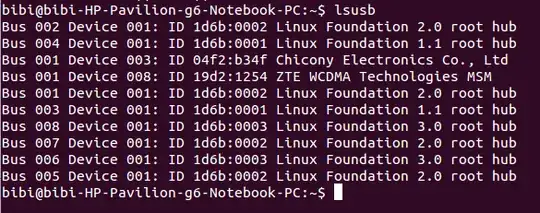

my lsusb output is like enter image description here
modem is ZTE WCDMA Technologies MSM
I noted down ID "19d2:1254"

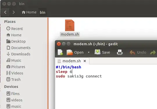

my modem.sh is

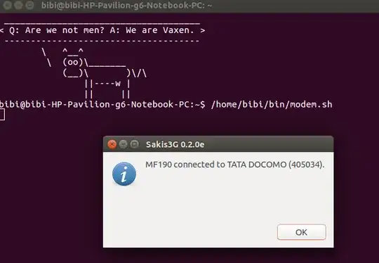

I am able to run modem.sh from terminal and connect modem.

Your problem is probably that sakis3g is not in a default location. Modify your script to use the full path. For example, if sakis3g is in your $HOME/bin folder, make your script look like this:
#!/bin/bash
sleep 6
/home/bibi/bin/sakis3g connect

It is working. Whatever steps I followed was correct. No changes were made. Problem was delay was a little more that made me think not working.
Also it was running without any notification. Normally a window will pop up with 'connecting' dialogue when I run sakis3g to connect internet. No notifications like 'connected' also I am getting as showed in question.
But on plugging modem it is getting connected automatically to internet in few seconds. :)
