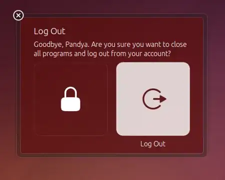

I am running Ubuntu 14.04 and user name is pandya.
pandya@pandya-desktop:~$ gnome-session-quit
When above command run without being sudo (sudo su) in terminal, it successfully logs out. enter image description here
