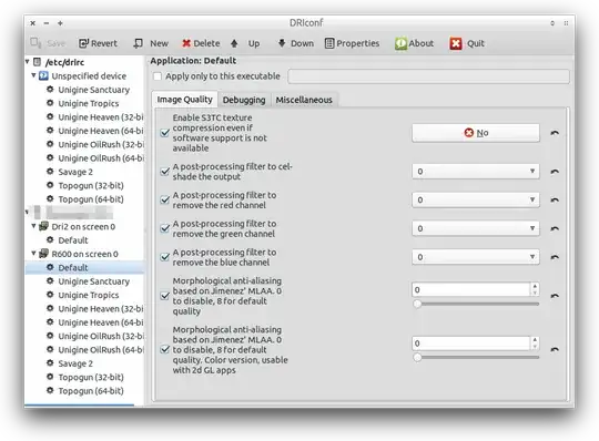

  1. DriConf - GUI for controlling the direct rendering settings (OpenGL) of all open-source drivers. Pretty hard to use and hasn't been updated since 2006. Phoronix has an overview and comparison to AMD's CCC.
    DriConf can be found in the 'universe' repository of Ubuntu and can be downloaded from the Software Center:
    Install via the software center

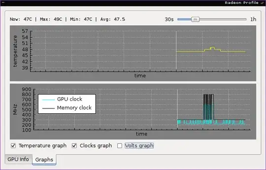

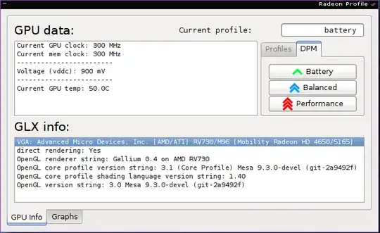

  2. radeon-profile - control power and clock settings on recent kernels (relies on new radeon dynamic power management). Documentation and support may be found in this Phoronix thread
    Unfortunately there aren't packages/PPAs available for radeon-profile. You will have to compile it manually.
