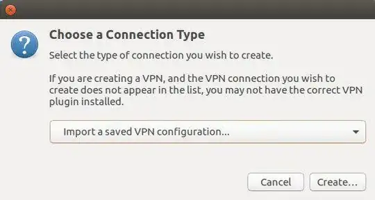

Easiest method is running this command:
sudo apt-get install network-manager-openvpn-gnome
And then add a OpenVPN connection from Network Manager which after above command supports importing .ovpn files.

I'm coming here from the locked How to setup VPN using an .ovpn file? [duplicate], because I wanted to give an answer to problems of importing *.ovpn files in the GUI, which some users experience.
Just like others, I've made sure to install:
$ sudo apt-get install network-manager-openvpn-gnome
However, on Ubuntu 18.04 (had same problem on 16.04; it works with the GUI on Ubuntu 22.04), I've not been able to import a *.ovpn file using the GUI (Settings -> Network -> VPN + -> 'Import from file'). I always get:
Cannot import VPN connection
The file "foo.ovpn" could not be read or does not contain recognized VPN connection information
Error: the plugin does not support import capabilities
However, I just stumbled upon the following instruction from nixCraft for importing a *.opvn file:
$ sudo nmcli connection import type openvpn file /path/to/foo.ovpn
Connection 'foo' (2f5739f4-2eef-f325-3c8a-6c12e124c90a) successfully added.
After running that command, my 'foo' VPN connection gets listed under 'Settings -> Network -> VPN'. After editing the password, my VPN connection works. The VPN connection is also listed in top-panel menu that shows connections, power, users among other things.

On Ubuntu 18, install network manager with the command:
Then...
  1. Reopen Network settings
  2. Retry importing file
The import should work fine.
