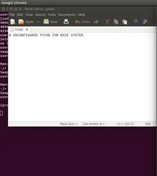

and his fstab looks like this
fstab
any way to fix this ??

It's possible the problem is because it's in the /mnt directory or it could be a security issue world readable swap isn't great. Try this tutorial and see if you have better results.
http://www.cyberciti.biz/faq/linux-add-a-swap-file-howto/
Elder Geek
  • 36,752
swapon failed: Invalid argument
Based on this discussion and this post, most likely your file system doesn't support swap files.
You need to create it somewhere outside of /mnt, as part of the native filesystem (e.g. in /var).
Try following these steps instead.
