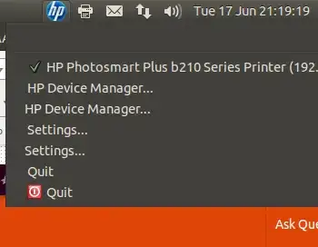

EDIT2: I upgraded to HPLIP-3.14.6. This seemed to fix the issue until I rebooted which caused it to return. I've also noticed that clicking on the HP icon gives a menu with several options listed twice. enter image description here
