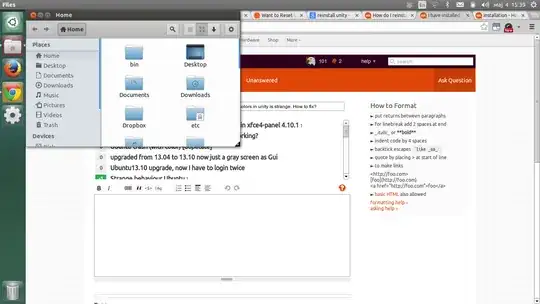

But now when I have restarted the machine, I first got xUbuntu log-out scree. WHen I got back to the login screen, I got Xfce (xubuntu) login screen, and even I login to the unity, I have xfce icons set up and the colors of the menu. Like this enter image description here
What I would like is to have a Ubuntu like login screen, and the ubuntu looks when I login to ubunty (unity) and not some mixed xfce-ubunty experience.

What seems to have happened is that XFCE have changed some settings on your system, as such, your Ubuntu looks the way it does. You're going to have to reset some of these settings back to their defaults by running a few commands.
