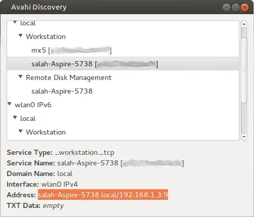

    2. Run avahi-discover, Your desktop should be listed in IPv4→local→Workstation
      Example in screenshot mx5 is my PC where salah-Aspire-5738 is an other machine.
