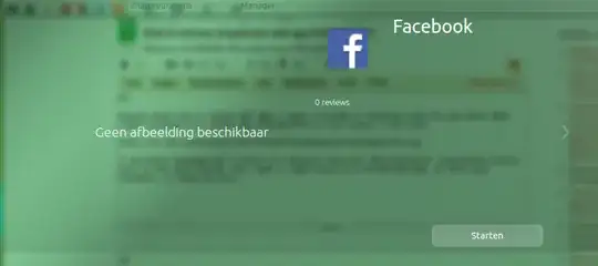

Anyone knows how to remove "web apps" I made in Chrome using menu => extra => create shortcuts (no real Chrome apps) from the app menu in Ubuntu? When right-clicking on a normal app (Thunderbird in this case), I see this:
I use Dutch language but I think it's obvious: note the "Deïnstalleren" (uninstall) button next to the start button. But, when I right-click on a Chrome web app (which I made from the menu => extra => create shortcuts), in this case Facebook, it shows me this:
Note the difference? No uninstall option. Can I achieve this in another way? Thanks in advance!

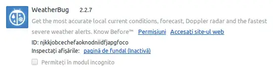

If it doesn't work, go to ~/.local/share/applications and look there for specific desktop files by ID. For example:
has the shortcut chrome-njkkjobcechefaoknodniidfjapgfoco-Default.desktop
