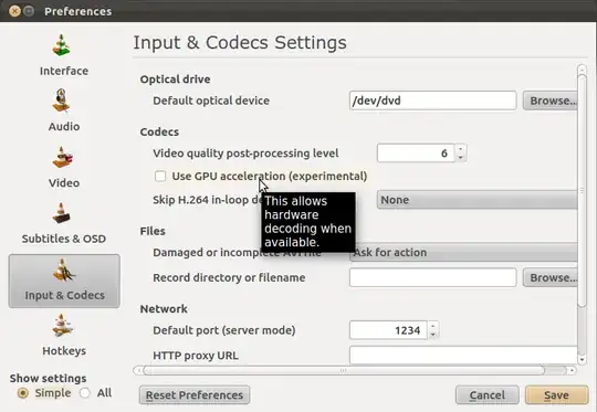

To enable gpu decoding in vlc thru vaapi & ffmpeg, two ways
From a terminal, no need to set in preferences
vlc --ffmpeg-hw /path/to/supported/video/name
To set in vlc's gui, the prior posts are incorrect as to how, actual way is shown in screen
Tools > Preferences > Input/Codecs > check the box, reading up on "Skip H.264 in-loop deblocking filter" may prove worthwhile
