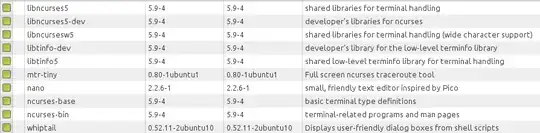

Below are my synaptic packages of readline installed on my computer. readline Below are my synaptic packages of ncursers installed on my computer. ncursers

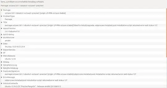

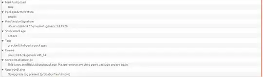

$ sudo apt-get install octave
Errors were encountered while processing:
 octave
E: Sub-process /usr/bin/dpkg returned an error code (1)
Third Image Third Image
Fourth Image Fourth Image

octave: symbol lookup error: /usr/local/lib/libreadline.so.6: undefined symbol: UP
dpkg: error processing octave (--configure):
 subprocess installed post-installation script returned error exit status 127
