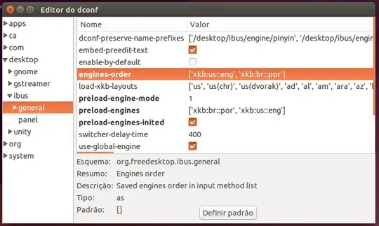

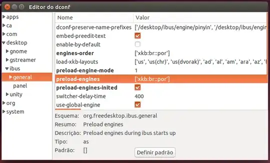

Found a solution for me.
Keyboard configuration
On terminal:
$ # If dconf-editor is not already installed
$ sudo apt-get install dconf-editor
$ dconf-editor
When the program opens do the following:
  • navigate to desktop.ibus.general enter image description here
  • remove 'xkb:us::eng' from both engines-order and preload-engines enter image description here
Works for me on Brazilian Portuguese, hope that works for you.
