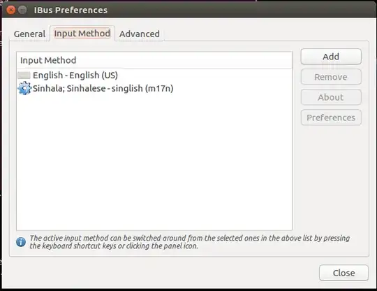

  3. Type following command in the terminal and go to the input method tab
    ibus-setup
  4. Configure ibus settings to use Sinhala.
    a. Select input method
    b. Select Add
    c. Select Sinhala-Sinhalese and OK
    d. Click En in Top right corner of your screen.
    e. Change it to Sinhala
Enjoy!
