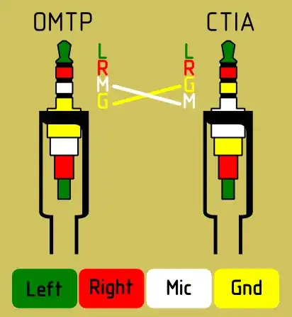

Apple EarPods use a special/different type of connector layout called CTIA.
Your Macbook works perfectly with CTIA headphones because they are both Apple products and implement CTIA. Your ubuntu setup most likely uses OMTP.
Here is an image depicting the mismatch:
This incompatibility will prevent you from using your Apple EarPods

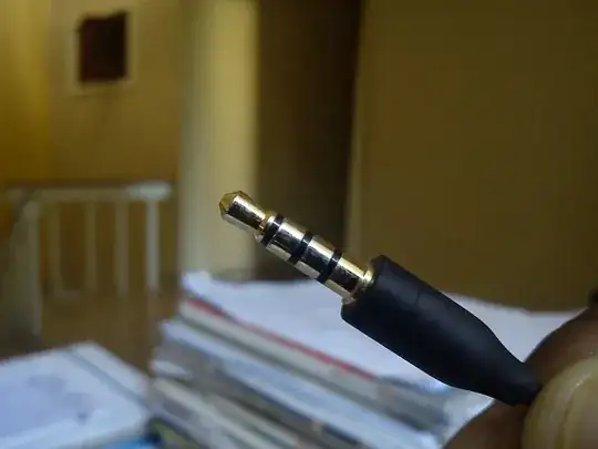

You headphone has a TRRS (tip-ring-ring-sleeve) connector. Which can be seen below.
Black rings separates the signal contacts. Here we have 3 black rings and 4 signal lines (contacts). These contacts are used for;
  1. Ground
  2. Stereo Signal-1
  3. Stereo Signal-2
  4. Button control
So, we must have 4 different contacts in the host device's connector (for example you laptops audio jack) to be able to use all of those signals.
You are telling that "I can not control volume via using the headphone's buttons". In this case we have to ask these questions;
  1. Does audio connector of our computer has 4 contacts in it (hardware thing)?
  2. If it does, does the machine has a DAC converter to understand button signals (still hardware thing)?
  3. If above questions are both yes, do we have proper drivers in OS to run this DAC component?
If you can say "yes" to all of the questions mentioned above but still Pc is not understanding the buttons, then;
  1. You may have a problem with your earpods.
  2. You have to dig more into to automatize capturing keypressed events and associating these events to an action (like volume up/ open web browser or anything else).
