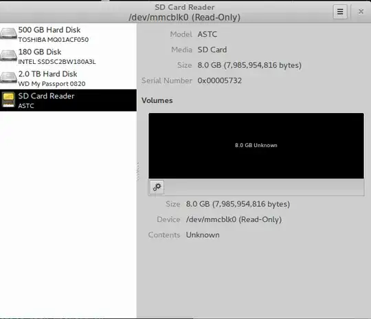

You can use the included Disks application
Click on the target partition. Now you can create new partitions, format the disk or change partition type.
