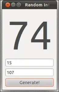

I don't know any software. Google didn't come up with something either. Guess this is too simple a problem. It should be about 30 lines of code if you wrote it in a scripting language. You could also create a LibreOffice spreadsheet to do that. Shouldn't be terribly difficult.
Edit 1:
pseudo-random number generator - perl gui script
Below is a quick and dirty perl script I coded. You should be able to modify it yourself. When you run it with perl nameOfTheScript.pl or make it executable with chmod u+x nameOfTheScript.pl and then double click it, it will look like in the picture above.
