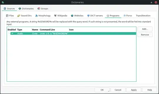

What worked for me:
  1. Install Crow Translate
  2. In GoldenDict, add crow -s en -u “%GDWORD%” to the "Programs" tab. The type should be "Audio". See figure below.
You can change the language of the TTS by changing the part -s en to another code like it for italian, fr for french, etc. See Crow translate documentation for details.

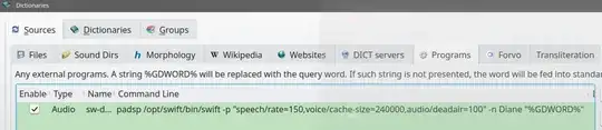

You can use swift program.
Example:
padsp /opt/swift/bin/swift -p "speech/rate=150,voice/cache-size=240000,audio/deadair=100" -n Diane "%GDWORD%"
fig
