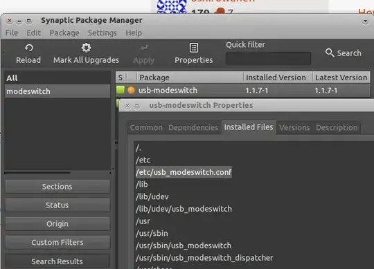

These are the 2 packages related to usb_modeswitch
usb-modeswitch
usb-modeswitch-data
Please check if both are installed.
/etc/usb-modeswitch.conf is part of usb-modeswitch as you can see here:
im2
I got here by opening synaptic, searching for modeswitch, clicking usb-modeswitch and then clicking properties and installed files.
1 thing: I am using 11.04.
In 10.04 you might have to install your own config file. If you did install from synaptic and it still does not work this topic suggests installing from source: usb-modeswitch and usb-modeswitch-data (but you are on your own here ;) ).
