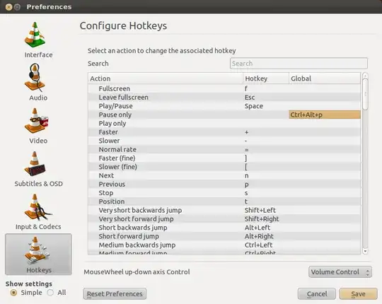

You can do this but seems more of a pita than worth considering there is a vlc appindicator or systray icon. (the systray icon works better than the indicator
Anyway vlc will respond to global hotkeys, then you'd use something like xdotool in your quicklist
The pita part is you'd need to create & set global hotkeys in vlc that don't conflict with anything else, then test that they work in vlc.
So as an example for pause, setting the global for 'pause' to ctrl+alt+p in vlc, see screen (you could do the play/pause toggle instead so only 1 quicklist entry needed
Then the quicklist entry, using xdotool which needs to be installed
[Pause Shortcut Group]
Name=Pause
Exec=xdotool key ctrl+alt+p
TargetEnvironment=Unity
Depending on what version of vlc you have after setting a global hotkey the next time you open the settings window it may not be displayed but will still be valid. Overall as mentioned a pita
