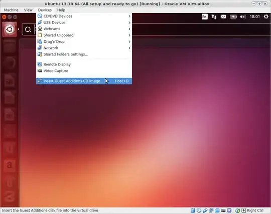

As Sylvain already explained, you need to install guest-additions on the guest. This can be done as he suggested on Debian based guests but a more general approach is to press Host+D or select the "Insert Guest Additions CD image" from the "Device" menu (shown here with an Ubuntu guest):
Once you have done that, follow the on screen instructions. The details may vary depending on the guest OS but this will always allow you to install Guest Additions, whatever the guest happens to be.
