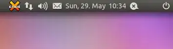

  2. Allow the tray icon to show. To do this, follow this answer and add 'Xchat' and 'xchat' to that whitelist:
    (You need to install the package dconf-tools for the program dconf-editor.)

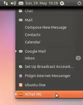

  3. Another alternative is to integrate XChat in the messages indicator by installing the xchat-indicator if you are using plain XChat, or xchat-gnome-indicator if you are using XChat GNOME. If you close the XChat window, you'll get it back via the XChat item in the messages menu:
