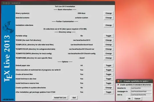

This opens up a nice GUI. You can to decide what to install in Installation collections. Also change the Create symlinks in system directories as in the screenshot so that the directories will be all laid out for you. This means you won't need to poke around and modify your system files post-installation.

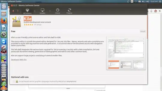

You can also use Kile - an Integrated LaTeX Environment.
You can easily install it from ubuntu software center.
