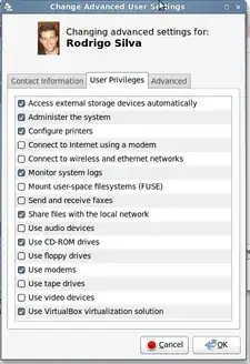

How does the "User Privileges" tab in the Advanced Settings of Users and Groups GUI work? I mean this window:
User Settings
Does it simply add or remove the user from certain groups, or is there something else? If so, why only a few groups are represented there? I mean, how does Ubuntu/Gnome/Whatever decide which groups appear in that list? And where does the "description" for each "privilege" comes from?

After some research, I answered my own question... Ill post here for reference, may help people with a similar question in the future:
Ive downloaded and studied the source code from gnome-system-utils package. The app itself is users-admin. And the short answer is:
Yes, this tab is only about adding and removing the user from certain groups.
Long answer:
There are some checks, for example, when removing the user from the admin group, that triggers a warning about if the user is the only administrator in the system, and prevents from revoking this privilege. But, basicaly, each "privilege" in the list is just an alias for a group. It makes sense, since security and privileges in Linux are closely tied to a user belonging (or not) to certain groups.
But not every group is represented in the Privileges list, only a few. And, believe it or not, the list is hard-coded! Groups and description strings!
Below is a list from all the groups represented in the privileges list, as of Linux Mint 10 (= Ubuntu Maverick 10.10 in that sense). The groups names and the descriptions shown in the list are taken directly from source code, file src/users/privileges_list.c. The explanation about some of them (when descrition is not self-explanatory) are taken from this blog (a bit outdated) and /usr/share/doc/base-passwd/users-and-groups.html (definately obsolete)

A privilege is only listed if its correspondent group exists in the system. So the following does not show here since Ubuntu do not create them by default: cdwrite, powerdev , proc, scanner, usb, video and wheel.
Groups vboxusers (and perhaps sambashare) are only created when you install that software, giving a false impression that this list is configurable and not hard coded.
