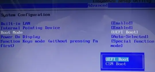

Did your computer come with Windows 8 or Macintosh installed, if so you have the UEFI BIOS setup. To get it to boot of of the flash-drive you will need to disable secure boot, Intel SRT, and FastStartup. After that you should be able to boot to the drive.
Stop here if that worked, keep reading if you still can't boot into the flash-drive.
If you still cannot boot to the drive you should try to change the boot mode, there are normally only two options, UEFI and legacy (legacy might be CSM Boot like in the example below). If you have any more questions or it still won't work let us know. I am certan everyone here is more than happy to help!
Example of boot mode
