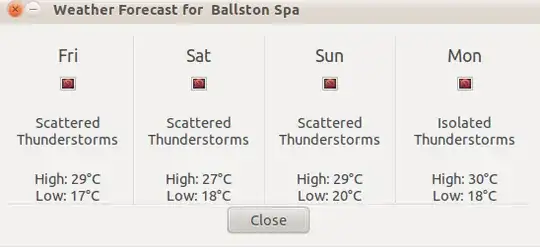

I've noticed lately that my Weather Indicator applet is no longer showing weather icons. If I select it to pull information from Google, I get this:
However, if I select it to pull from Yahoo, the weather icon displays in the notification area, but will not show icons in the forecast menu, like this:

I'm a developer for indicator-weather, which is what it looks like you're using. As @atareao mentioned, Google changed its icons. Yahoo should still work for current weather, but all forecasts are from Google and so will also be broken.
If you want to keep using indicator-weather, I recommend installing our PPA: ppa:weather-indicator-team/ppa . The version in the ubuntu repositories does not get updated frequently, and our PPA version has many new bug fixes. There's more information on our Wiki.
Once you've updated to the new version, don't forget to quit and reopen indicator-weather to get the new version.
