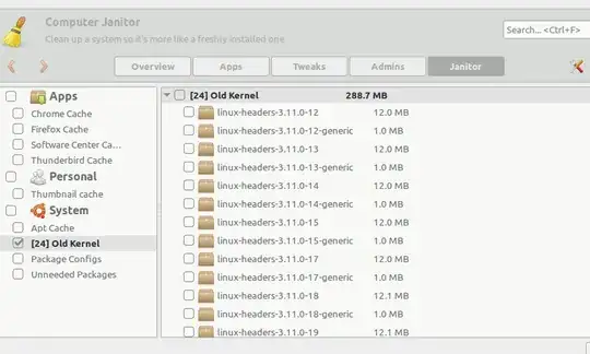

The easiest way is to install Ubuntu Tweaks:
Select the kernels you want to remove and go on --- I normally leave the newest of the current series and (if available) the older of the previous (like a 3.8 kernel).
Be careful that if you have some manually installed kernel (upstream, testing, etc) the janitor will remove all your automatically upgraded kernels if you tell him to remove all kernel in the list --- and then you need to reinstall manually linux-generic to go back to the standard kernel line. Do not delete the most recent old kernel as a rule of thumb and be safe.
Normally you have the error while upgrading, and that means you can have a failed upgrade linging; I would advise a
sudo apt-get install -f
sudo apt-get update
sudo apt-get dist-upgrade
after the cleanup.
