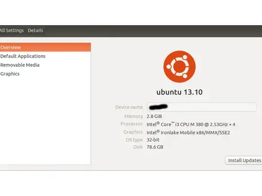

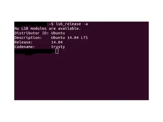

Command line shows ubuntu version as 14.04 while GUI shows 13.10.
I was upgrading my system yesterday from 12.04 to 14.04. When around 60-65% updates were installed, I had to shut down the system. When I restarted the system in the morning, the system booted fine but now it shows the above problem as shown here and here.

This is output of sudo apt-get update. It clearly shows that updates are being made from 'trusty'. I tried to upgrade to 14.04 (Assuming I was on 13.10) using sudo update-manager -d But I got message saying "Software is up to date".

I think you have similar case to mine. As Ubuntu forked gnome-control-center, you may have both already installed after upgrade.
  • Open terminal, run unity-control-center → Details
    You should see 14.04 Logo
  • Open terminal, run gnome-control-center → Details
    You may see 13.10 Logo, like mine (I think someone forget to update it as it's not important, fresh Ubuntu install has only unity-control-center)
    To check run:
    xdg-open /usr/share/gnome-control-center/ui/UbuntuLogo.png
    xdg-open /usr/share/unity-control-center/ui/UbuntuLogo.png
I think it's just matter of logo image, no relation to upgrade or graphic glitch. This is related bug report lp bug#1281155 "About this Computer" shows 13.10 instead of 14.04
