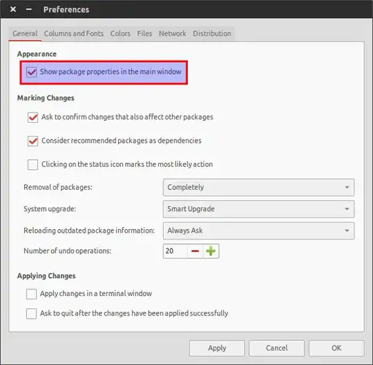

After that open Synaptic from the dash or form terminal by typing gksu synaptic and first go to Settings -> Preferences and check this box:

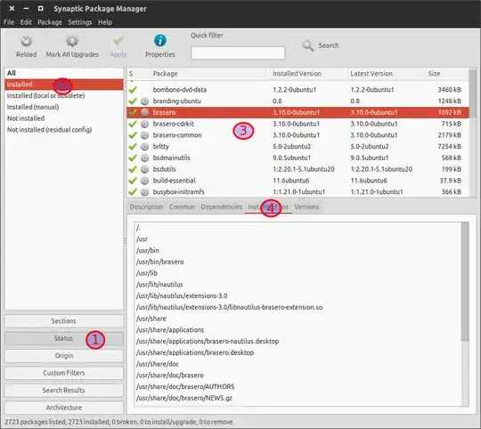

Now follow the steps in the image:
