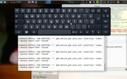

On screen keyboard is already available in Ubuntu 14.04
If you run,sudo apt-get install onboard
Reading package lists... Done
Building dependency tree
onboard is already the newest version
To open onboard:
Open terminal and run:onboard
or from dash:
