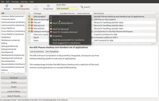

1)Install kde desktop as a session; in synaptic kde-standard : enter image description here

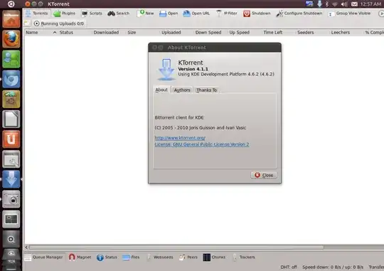

5)Then return to ubuntu and now you have Ktorrent 4.1.1 in Ubuntu!! :D
