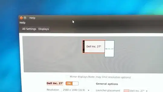

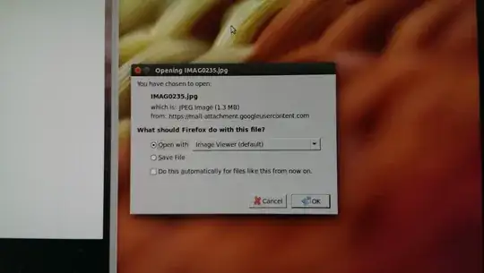

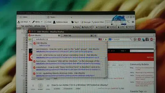

After a restart the flickering issue was gone and my two monitors appeared to behave mostly ok (only problem is that the CCW I put on my 2nd monitor doesn't survive a restart), but the icons, buttons and theme remain looking like they came out an old version of Gnome. Also, the menu bar appears twice in every window: once in the title bar and once well as below in it's own barHere are some photos to show what I mean (sorry about the quality; I had to take them with my phone because the 'Print Scrn' button has also stopped working after the upgrade):
How can I fix this and get my 14.04 looking as beautiful as it was designed to look?
