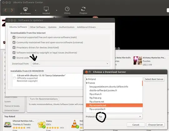

To ensure that the upgrade will use the FTP protocol, you basically need to update your software sources to use a ftp mirror.
To do that the best approach is to use the Ubuntu Software Center.
  1. Open Software Center
  2. Open the Edit -> Software Sources... menu
  3. Select Others in the Download from list
  4. Finally choose a mirror supporting the ftp ptotocol (it will update /etc/apt/sources.list automatically)
