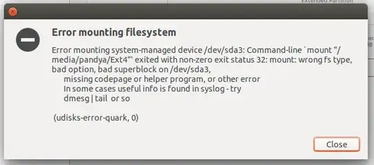

It gives error on startup and ask S for skip and M for manual mounting.I skipped and try to mount with disk (installed app from dash earlier disk-utility), it gives error:
But If I mount with command: sudo mount /dev/sda3 /media/pandya/Ext4 at startup (By pressing M for manual mount) or after started up (from terminal), then it mounts properly.
Gparted also mounts that drive on /media/pandya/Ext4 Successfully.

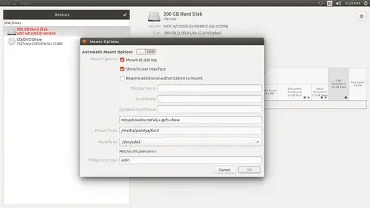

I also checked /etc/fstab and entry for /dev/sda3, which is proper
/dev/sda3 /media/pandya/Ext4 auto nosuid,nodev,nofail,x-gvfs-show 0 0
I used same auto-mount options for all drive. Then why only one is not auto-mounting?

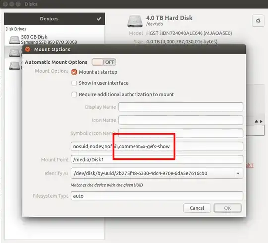

As @Jos suggested, this is the bug Bug #1012081: util-linux needs updating to 2.24.2 and can be fixed by adding comment= in front of x-gvfs-show.
