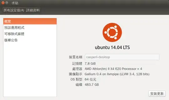

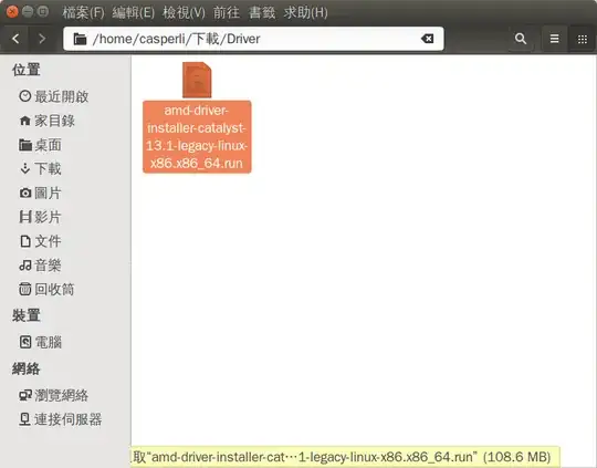

  1. Downloaded the official driver from AMD.com : http://support.amd.com/en-us/download/desktop/legacy?product=Legacy2&os=Linux%20x86_64
  2. Now I have this : enter image description here

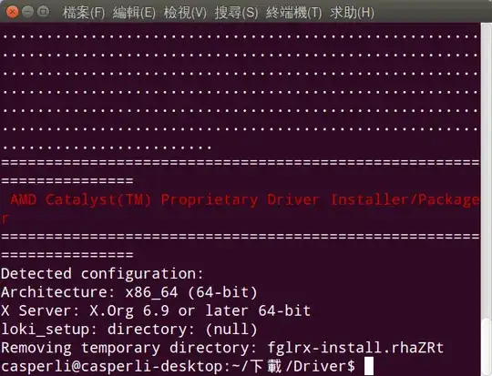

  4. Did this in the terminal : sh amd-driver-installer-catalyst-13.1-legacy-linux-x86.x86_64.run enter image description here

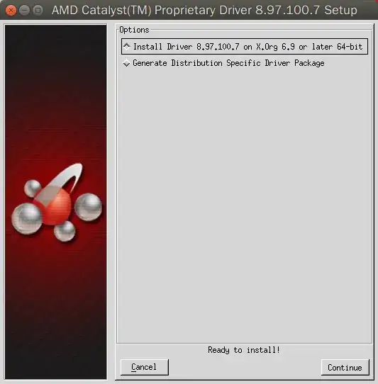

  5. I got this windows, chose the first option and then click "continue" : enter image description here

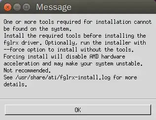

  6. And this windwos : enter image description here
    .log file : http://paste.ubuntu.com/7320170/

Desktop Information
OS           : Ubuntu 14.04 LTS (64 bits)
Display Card : MSI R4770 Cyclone (ATI Radeon HD 4770)*
CPU          : AMD Athlon II X4 620

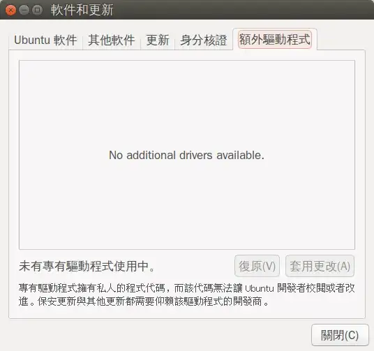

* "No additional drivers available" in "Additional Driver" page

Your log suggests that you are missing the linux-headers-generic package.
You can install this by either searching the software centre or entering in a terminal
sudo apt-get install linux-headers-generic
Should the install continue to fail you may also need to install build-essential, gcc,dkms and make.
you can do this in a terminal by typing sudo apt-get install build-essential dkms gcc make
That windows is telling that you may do this prior to launch the .run file:
sudo apt-get install fglrx
But maybe you must do all this:
sudo dpkg --add-architecture i386
sudo -i
cd /etc/apt/sources.list.d
echo "deb http://archive.ubuntu.com/ubuntu/ precise main restricted universe multiverse" >ia32-libs-raring.list
apt-get update
apt-get install ia32-libs
rm /etc/apt/sources.list.d/ia32-libs-raring.list
apt-get update
exit
Then do:
sudo ./amd-driver-installer-catalyst-13.1-legacy-linux-x86.x86_64.run --force
