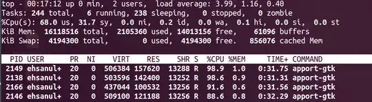

I'm getting 100% CPU usage at startup consistently by apport-gtk as shown here.
screenshot
According to Apport wiki shouldn't even be running on my machine since it's not a beta version (although I upgraded from 14.04 LTS Beta 2 to the release version).

Take a look and delete all files in /var/crash/:
rm /var/crash/*
I suddenly had the same problem apport-gtk taking 100% on every restart.
Seemed there was a huge (2GB+) bogus crash file in /var/crash/ that couldn't be parsed. After several minutes of waiting I always ended up with this rather mysterious dialog:
This problem report is damaged and cannot be processed. Error('Incorrect padding',)
After I deleted the file in /var/crash/ both issues were gone.
