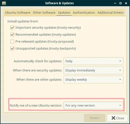

You need to check this option:
Then launch do-release-upgrade again
