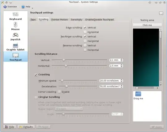

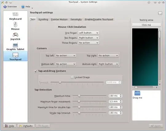

On my fresh Kubuntu 14.04 LTS install, the synaptiks package was not installed (or available), but the touchpad drivers were detected and configured correctly.
Thus I'm running KDE, not Gnome.
I can access settings for "circular scrolling" and "disable touchpad when mouse is plugged in" by accessing the touchpad settings under System Settings > Input Devices > Touchpad.
Thus no reason for me to install the synaptiks package on my current hardware stack.
See screenshots below:
