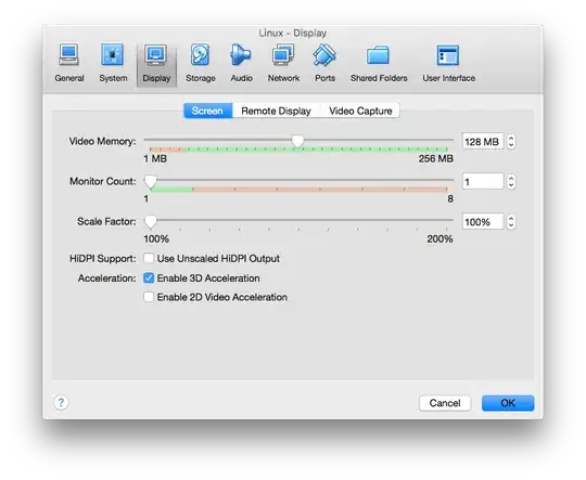

Enable 3D acceleration from virtual machine setting worked! I haven't tried that because in 12.04 I didn't have that selected so I thought it should work without it.

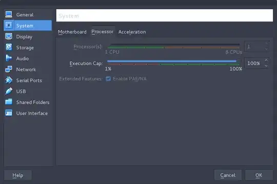

Watch out for the "Execution Cap" setting under the processor setting for the virtual machine. I stumbled upon a user having it set to 1% when it normally should be at 100%.
You can find it under 'System'->'Processor'->'Execution Cap'. It's a slider.
Sorry for my ugly theme.
Run Oracle VB Select your VM on the LHS Settings -> Display - > Video tab, "Enable Features:" and check the Enable 3D Acceleration box Click OK
